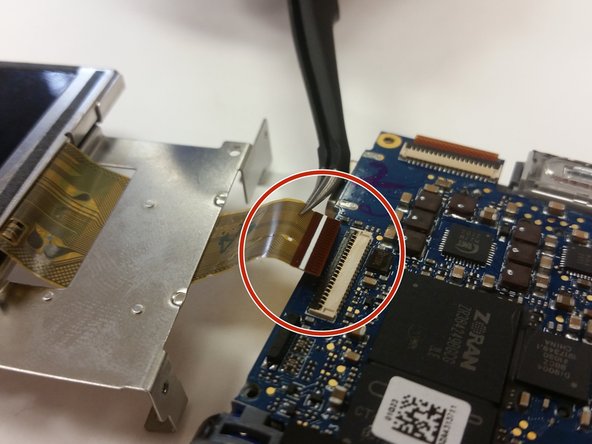

  • Flip the ZIF connector's locking bar vertically, then gently remove the ribbon cable.
  • Remove the screen.
