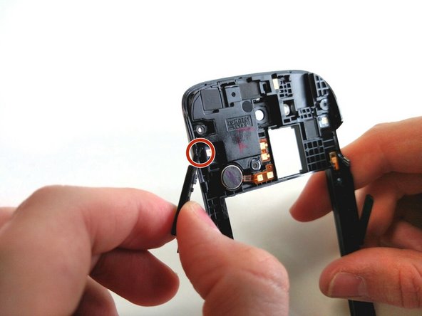

  • The volume rocker is held into the frame by two small prongs.
  • Carefully unhook the prongs from the frame by pulling to the side and remove the volume rocker.
  • The prongs on the volume rocker look like this.
