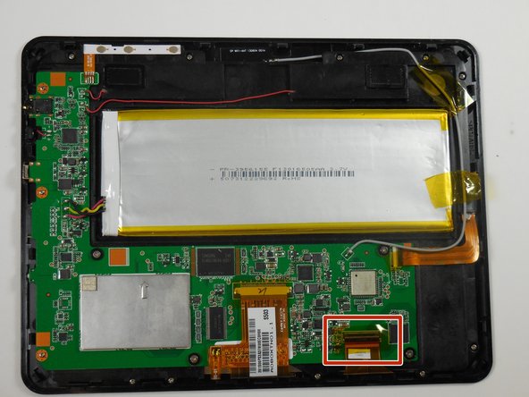

  • Remove the second ribbon cable by prying up the black flap using a spudger.
  • Pull the ribbon cable horizontally directly away from the battery.
