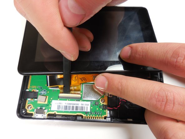

  • For the larger orange connection, there is a white tab holding the connection to the circuit board.
  • Lift the white tab gently with the plastic spudger and remove the orange connection from the circuit board.
