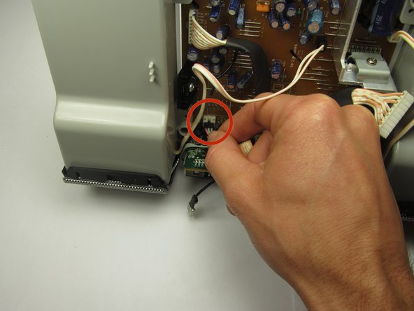

  • Unplug the 3 pin connector for the infrared sensor by pulling in the direction of the cable.
  • The wire is near the ground wire tab.
