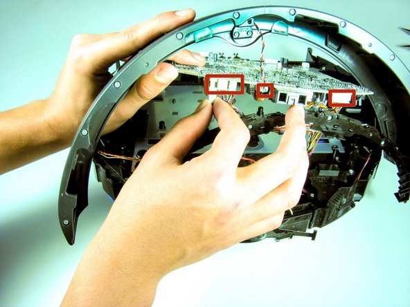

  • Disconnect the three cables that attach the motherboard to the front of the Roomba.
  • Lift up the motherboard, cliff sensor belt, and front bumper up and out of the way.
