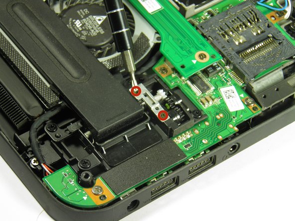

  • Remove the two silver 3mm screws with a Phillips 00 screwdriver.
