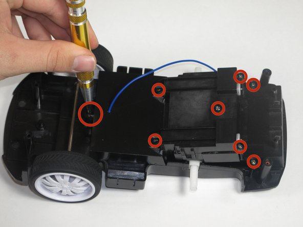

  • Remove the eight 5mm Phillips #0 screws located on the top of the motor/circuit board enclosure.
  • Vertically lift the motor/circuit board enclosure from the car chassis.
