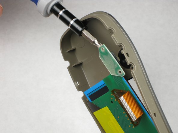

  • Gently remove the LCD screen from the case by lifting the area that held the two #1 Philips screws.
  • Do not remove the LSC screen by lifting the sides, only the area that held the two #1 Philips screws.
