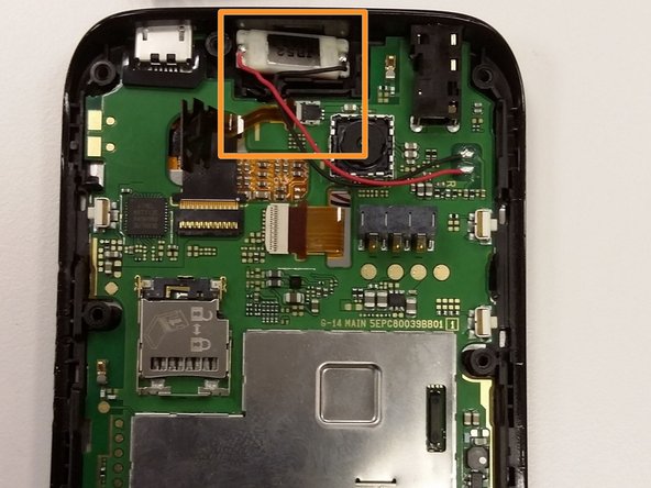

Repositioning the speaker.
  • Grab the speaker by its black and red wires with tweezers. Pull the wires down and to the right side of the phone.
  • The speaker wires tend to move back to their original position - you may find it helpful to secure the wires behind the battery terminals to keep your work area clear.
