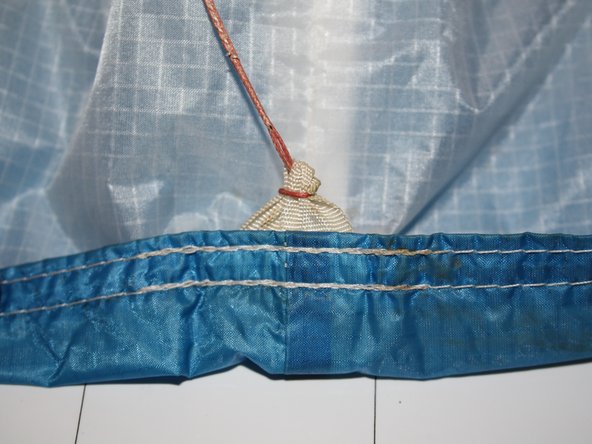

Disconnect the line from the suspension loop on the glider
  • The line is looped through the suspension point on the glider in the same way as the lines are connected on the cascades or simple line to line looped through connections
  • Carefully push the line against the suspension point to loosen the connection
  • Pull the open end of the line through the suspension loop
  • remove the lines loop from the suspension point
  • The - in this case damaged - line is free
