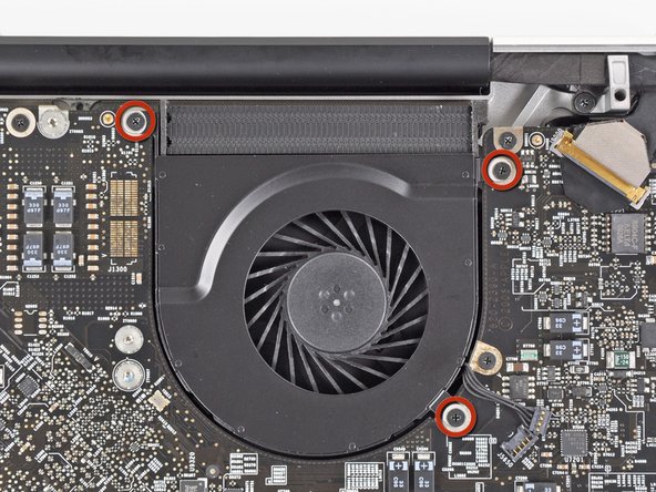

  • Remove the three 3.1 mm Phillips screws securing the left fan to the logic board.
  • In the Late 2011 MacBook Pro 17" Unibody these screws will be T6 Torx.
