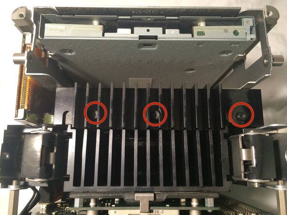

  • Remove the three top screws of the hard drive use a T8 bit and remove the heat sink.
  • Carefully slide the hard drive to the open side (side without the IDE and power cables) to remove the drive.
  • Turn the drive over, remove the sled rail with a T10 driver for its two screws. Transfer the rail to the same side on the new drive.
  • Insert new hard drive.
