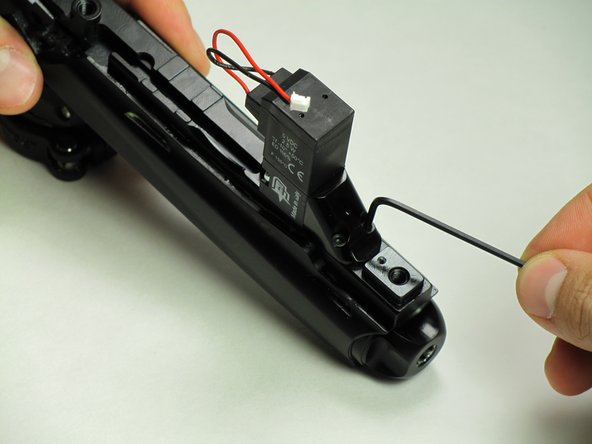

  • Remove the two black hex bolts that connect the solenoid mount to the body.
  • Use the 5/64" Allen Key to rotate each screw counter clockwise.
