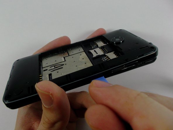

Remove the Inner Cover
  • Take the plastic opening tool and insert it in the crease between the front screen and the inner back cover.
  • Slide the plastic opening tool along the edge of the phone to pry the covers apart.
