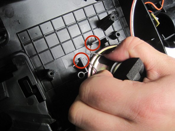

Sony TCM-919 Cassette-Corder Speaker Replacement, Remove Speaker: crwdns2935265:00crwdnd2935265:01crwdnd2935265:02crwdne2935265:0 Sony TCM-919 Cassette-Corder Speaker Replacement, Remove Speaker: crwdns2935265:00crwdnd2935265:02crwdnd2935265:02crwdne2935265:0
Remove Speaker
  • Squeeze the two prongs holding the speaker in place and remove the metal piece.
  • Remove the speaker by gently lifting it up from the cover and pulling.
