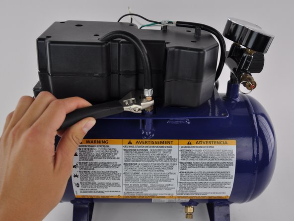

Campbell Hausfeld FP204800 Manifold Assembly Replacement, Removing Exhause Tube: crwdns2935265:00crwdnd2935265:01crwdnd2935265:01crwdne2935265:0
  • Unscrew the exhaust tube from the check valve using a smart wrench.
  • You do not need to remove the check valve, only the exhaust tube.
