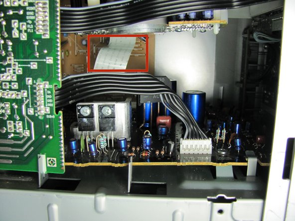

Removing Panasonic SC-PM31 Top and Side Panels, Removing the white ribbon wire: crwdns2935265:00crwdnd2935265:01crwdnd2935265:01crwdne2935265:0
  • Looking in through the side nearest the power button, use your fingers to pull the white ribbon connection toward you, away from the rear circuit board.
  • The process will require the use of moderate force and can be eased by wiggling the ribbon during removal.
