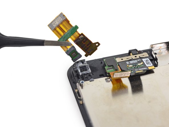

  • For this last Dynamic Perspective camera we decided to (totally on purpose) remove the image sensor and camera cable from the lens assembly (for science).
  • The lens remains as a sweet black hole in the front panel assembly.
  • This camera shares its cable with the headphone jack contact board and another infrared LED.
  • This can be potentially bad news—you'll have no serenity should any of the components on this board choose to betray you.
