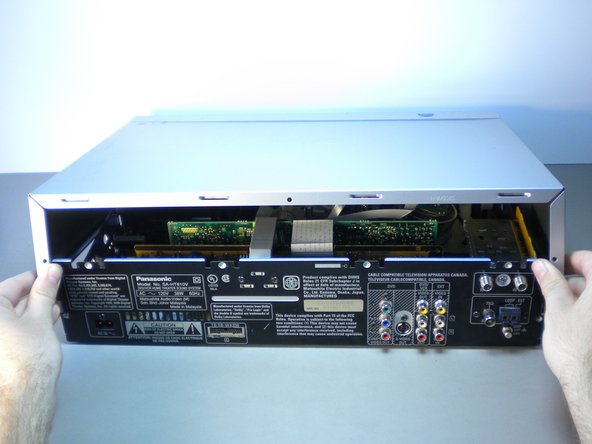

  • Before removing cover make sure that the back of the device is facing you.
  • Remove the top cover by bending out on the sides, and pulling the cover towards you while applying upward pressure.
