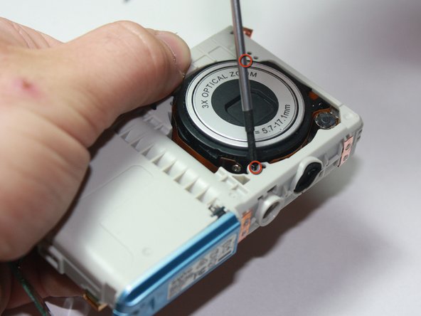

  • Using the Phillips #00 Screwdriver, remove the two screws holding the lens in place.
  • Use your other hand to hold the lens in place so the lens does not fall out while removing the screws.
