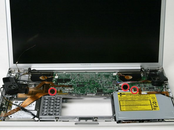

  • In order to disconnect the speaker cable from the front edge of the logic board, you must disconnect the sound cable, the optical drive cable, and the PRAM battery cable.
