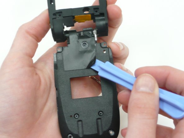

  • Flip the phone over and gently use iPod opening device to remove the right half of the black tape.
  • Be careful because the tape is holding a ribbon wire.
