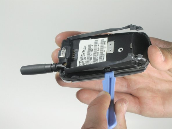

  • Use spudger to pry up back cover from the two side clips.
  • NOTE: sticker might be attached to rest of phone.
