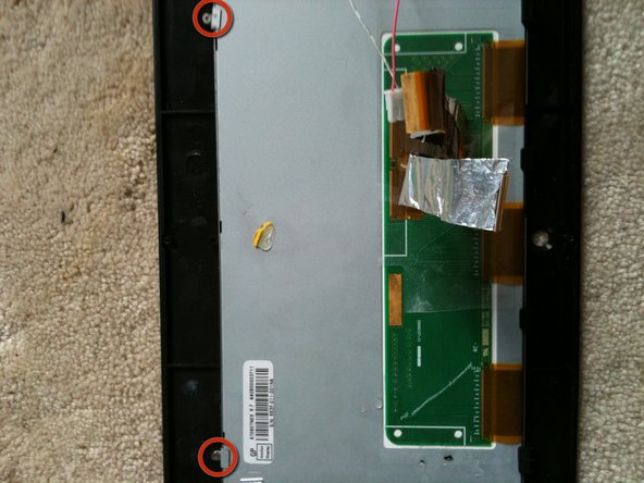

  • Remove the screws with a philips 00 screw drives, and remove the two metal brackets holding the LCD to the cheap black frame.
  • The lift the display from the plastic frame.
