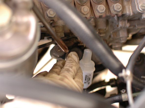

  • Install the new filter by retracing the steps so far, just backwards.
  • This is a good time to consider replacing the large secondary filter. If you would like guidance on this, see the secondary fuel filter replacement guide.
  • Then, pump the primer pump on the car until the primary filter fills with fuel. It's normal for there to be a small air bubble in the primary filter but it should be mostly clear.
