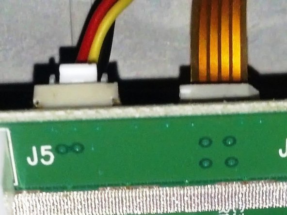

  • close up of the front upper right corner of the board sitting in it's mounting spot.
  • there is a bk/rd/yw wire plugged into the back of the board.
  • on the right there is a 'gold' ribbon cable also plugged into the back.
  • the bk/rd/yw wire is a snap in clip as usual
  • the ribbon cable slides, silver edge revealed down, into a slot. it does not clip in or lock in any manner.
  • the ribbon cable is rigid, it is somewhat flexible, but difficult to damage. if you crimp it, that would probably be the worst thing and may break it.
