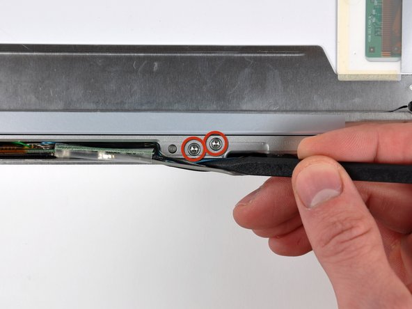

  • Remove the two 10.3 mm T8 Torx screws securing the right side of the clutch hinges to the front bezel.
  • Pull the clutch cover away from the positioning posts holding it on the front display bezel.
