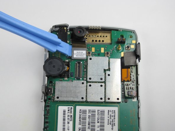

  • Take out the camera and attached chip with the iPod removal tool. Carefully pry the chip off its connection and the camera will come out too.
