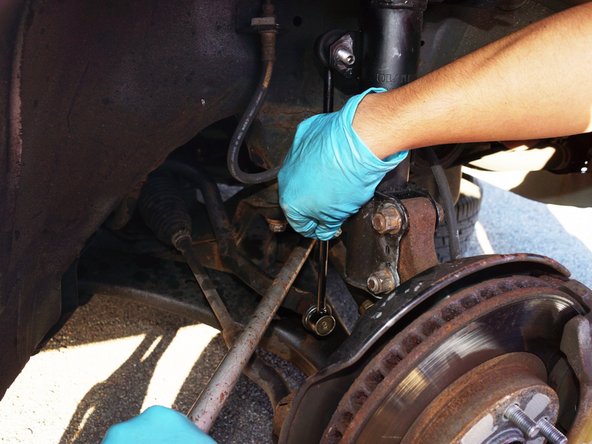

  • To put the new sway bar link in, use the bar from the hydraulic jack to push down the sway bar, and then insert the new sway bar link.
