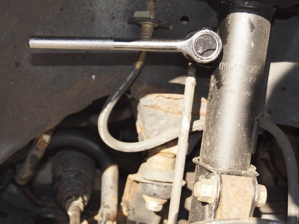

  • Use the 14mm socket wrench to take off the top nut.
  • If the sway bar link's joint is spinning and the nut does not come off, use the 4mm Allen wrench to hold down the sway bar link. See the second picture for details.
