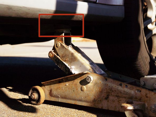

  • DO NOT USE THE JACK TO KEEP THE CAR LIFTED. Place jack stands or cinder blocks underneath the car.
  • You will need to begin by jacking up the front of your car. If you need help with using a hydraulic jack, see the guide below:
  • How to Jack Up a Car (or Truck)
  • Take the 14mm lug wrench and loosen all the bolts until they come off of the wheel and remove the wheel.
