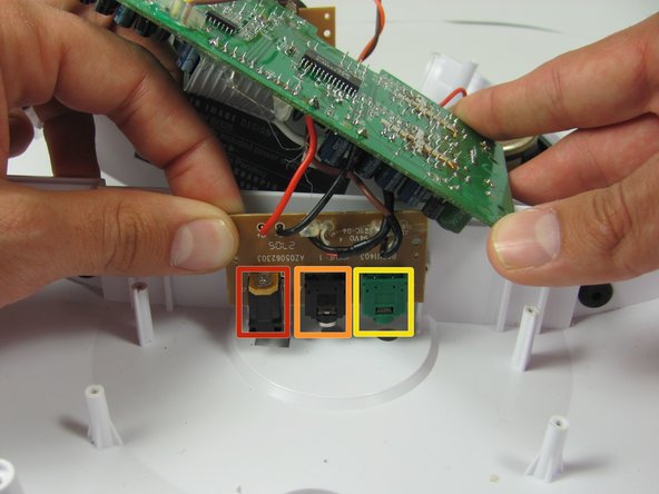

  • Lift up the circuit board containing the Auxillary, DC, and sub inputs and move the lower case out of the way.
  • Turn the circuit board over so the solder is visible. Depending on which input is broken remove the solder connecting either the Auxillary, DC, or Sub input.
  • DC input
  • Auxillary Input
  • Sub Input
