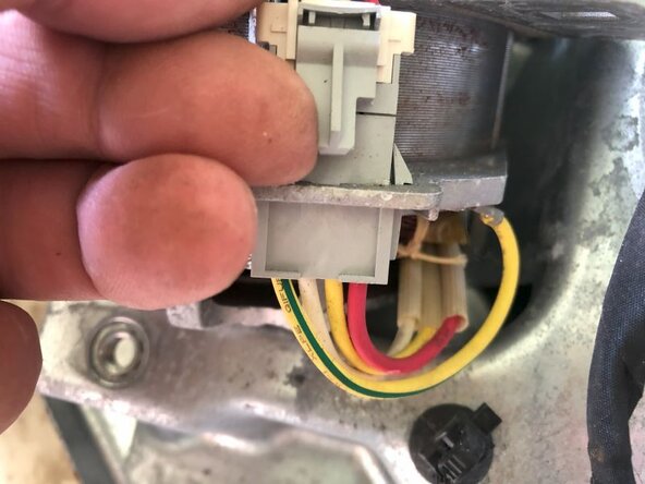

  • lift the locking tab with your fingernail (or a small screwdriver will work as well )
  • pull on the connector, (not the wire!)
  • until the connector comes free
