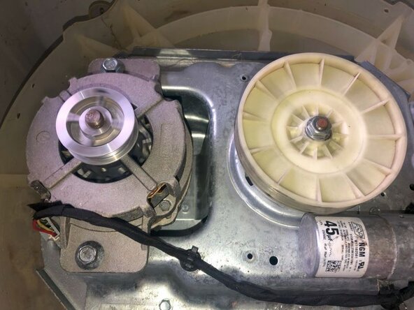

  • Belt is now removed
  • The motor is held to the housing by two 13mm machine bolts
  • I am using a 13mm socket to remove one,
