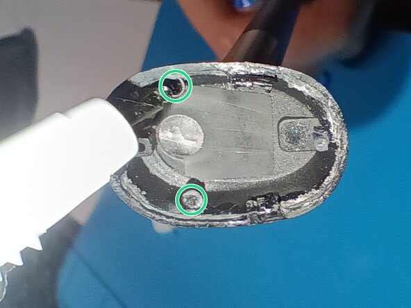

Closing the earbuds, Apply B7000: crwdns2935265:00crwdnd2935265:01crwdnd2935265:01crwdne2935265:0
Apply B7000
  • As the original adhesive for the pins is a flexible one it is recommended to use something similar like B7000 for them.
  • This makes future disassembly easier if needed.
  • Super glue can be used as well if this is not of concern or a fitting adhesive isn't available.
