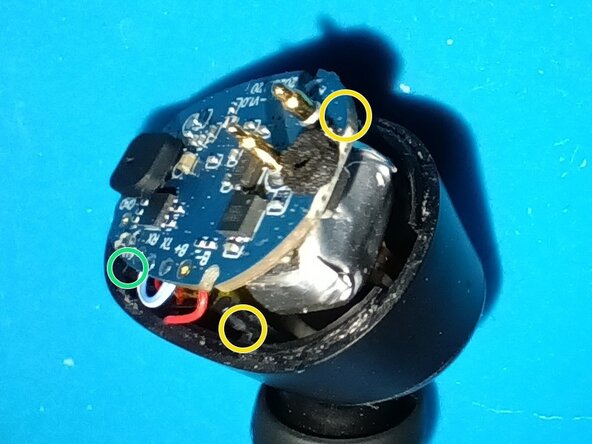

fix rattling sound, Glue down the PCB: crwdns2935265:00crwdnd2935265:01crwdnd2935265:02crwdne2935265:0 fix rattling sound, Glue down the PCB: crwdns2935265:00crwdnd2935265:02crwdnd2935265:02crwdne2935265:0
Glue down the PCB
  • Put a bit of super glue on the pin that was cut of at the beginning of this guide (green marker) to secure the PCB again.
  • Optionally put some on the other 2 pins marked in yellow too.
