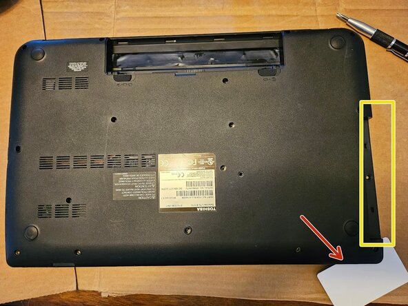

Pry off bottom cover
  • Insert the spudger (can use old credit card, ID card, etc.) between seam of the cover.
  • This may be easiest to do near the optical drive.
  • Use the spudger and your fingers to separate the cover around the entire bottom of the laptop, eventually the cover will be free.
