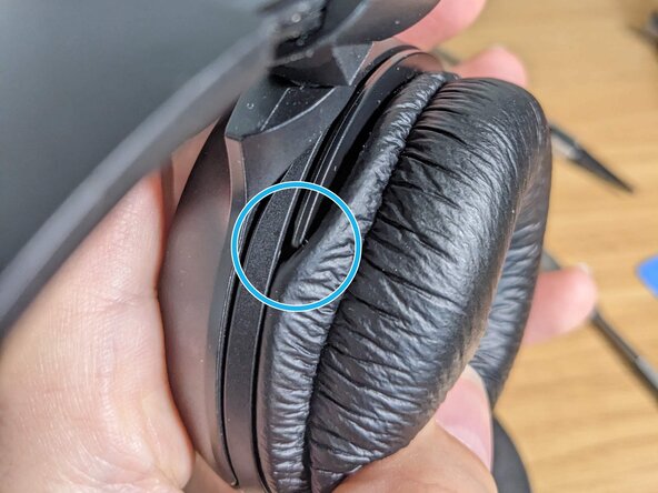

JBL Tune 510BT Ear cup holder replacement, Re-add the ear covers: crwdns2935265:00crwdnd2935265:01crwdnd2935265:01crwdne2935265:0
  • When reinstalling the ear-cover, use the little notch in the plastic to make it easier for yourself.
  • Once you manage to get a tiny bit holding in the grove, slowly rotate the cover until a full rotation is complete.
  • After you are done, you should be able to rotate the cover freely with minimal resistance.
