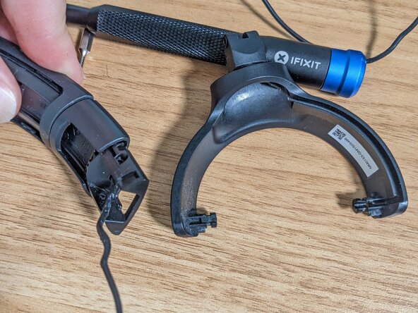

Slide the new earpiece holder in place
  • We can now start to reassemble the replacement piece.
  • Slide the new earpiece holder over the cable, making sure you do not kink or break the small wires that compose it.
  • Note: If you want to keep the older sticker from manufacturing, now is a good time to transfer it. You can soften the glue with some isopropanol and stick it to the new piece.
