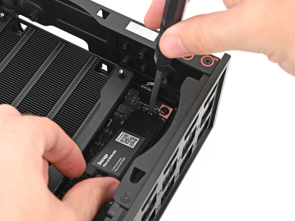

Remove the primary storage heat spreader screw
  • If your SSD comes with a pre-installed heat spreader, follow the next two steps. Otherwise skip here.
  • While securing the primary storage heat spreader with one hand, use your Framework Desktop Screwdriver to remove the 4.5 mm‑long T5 Torx screw securing it.
