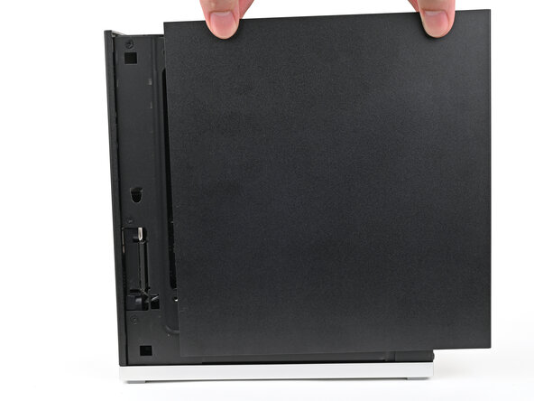

Install the Right Panel
  • Slide the Right Panel onto the right edge of the chassis and press it flat to ensure its clips are slotted into place.
  • There should be a small gap between the bottom of the Right Panel and the silver base.
  • Push the Right Panel towards the base of the computer to engage the clips.
