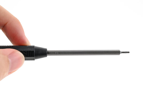

Loosen the primary storage screw
  • Make sure your Framework Desktop Screwdriver has the T5 Torx bit (labeled as T5) facing outwards. If it's not, pull the bit out and flip it.
  • Use your Framework Desktop Screwdriver to loosen the captive screw T5 Torx securing the primary storage heat spreader.
  • The heat spreader will pop up to an angle when its screw is fully loosened.
