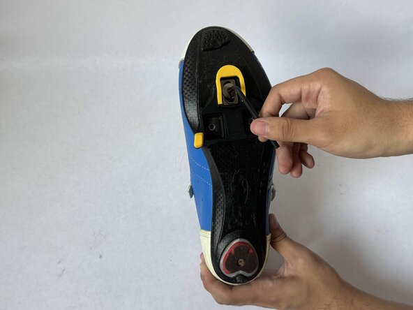

  • Securing the new cleat
  • Insert all screws and lightly screw in and test the cleat for comfort. Once done testing tighten the screw until the cleat does not move.
  • (Warning - Do not over tighten the screw as you risk damaging the threads of the screw)
