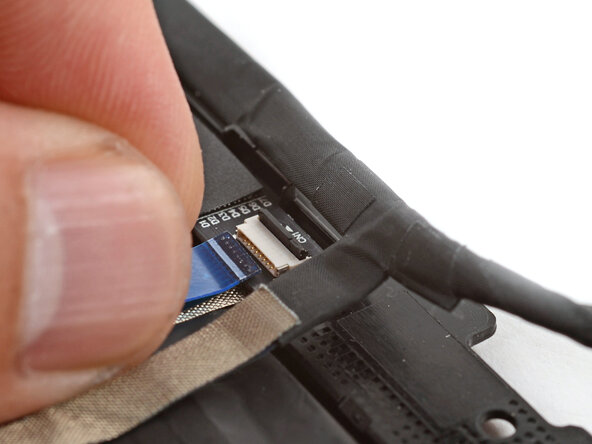

  • Slide the touch control cable into the ZIF connector up to the printed line on the cable.
  • Use your finger to flip down and gently press the locking tab in place.
