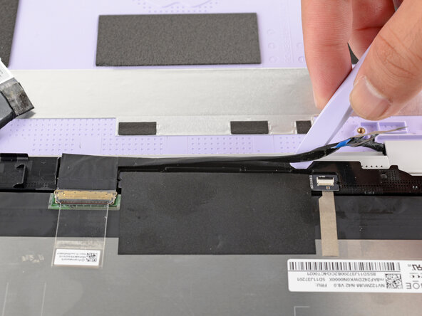

Framework Laptop 12 Display Removal, Detach the display cable: crwdns2935265:00crwdnd2935265:01crwdnd2935265:03crwdne2935265:0 Framework Laptop 12 Display Removal, Detach the display cable: crwdns2935265:00crwdnd2935265:02crwdnd2935265:03crwdne2935265:0 Framework Laptop 12 Display Removal, Detach the display cable: crwdns2935265:00crwdnd2935265:03crwdnd2935265:03crwdne2935265:0
  • The display cable is lightly adhered to the bottom edge of the display.
  • Slide the flat end of your Framework Screwdriver under the length of the display cable to separate it from the display.
