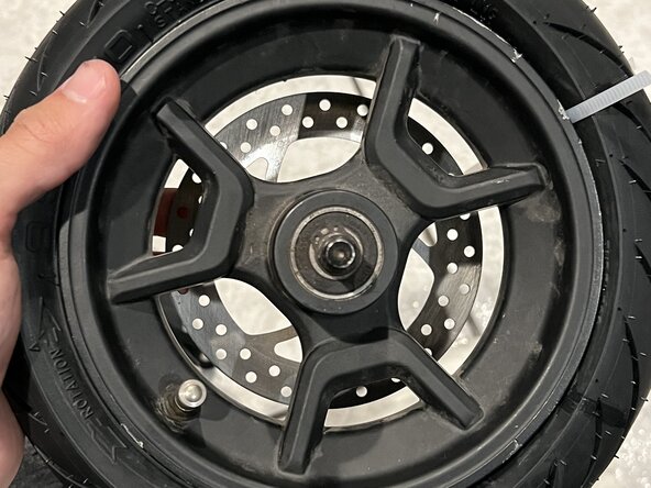

  • You will now get soapy water and apply it all around the tire.
  • You’ll now press down on the rim using the tire so it can slip in to the rim, then after cut off the zip ties off the tire using scissors.
