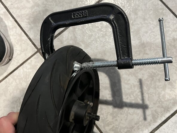

  • Now, you’ll need your clamp to squeeze around the tire in order to take it off rims bead.
  • After, You’ll need two strong flat head screwdrivers to start removing the tire off the rim while the clamp is still on, as shown in the third photo.
