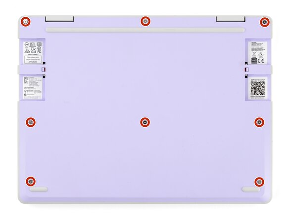

Framework Laptop 12 Input Cover Installation (No Expansion Cards), Tighten the bottom screws: crwdns2935265:00crwdnd2935265:01crwdnd2935265:02crwdne2935265:0 Framework Laptop 12 Input Cover Installation (No Expansion Cards), Tighten the bottom screws: crwdns2935265:00crwdnd2935265:02crwdnd2935265:02crwdne2935265:0
  • Use your Framework Screwdriver to tighten the eight captive T5 Torx screws on the bottom of your laptop.
  • Tighten the screws until they're snug. Don't over-tighten them, or you may strip the screws.
