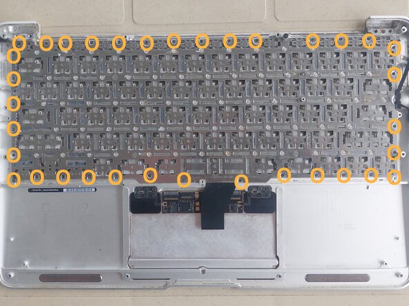

  • Once the backlight has been removed from the case we can now proceed to remove all the tiny screws that run around the outer edges of the keyboard.
  • Using a small Phillips screwdriver undo and remove ALL of the tiny screws that are around the edges of the keyboard, There are 34 of them in total.
  • It is imperative to double check that ALL of the screws have been removed otherwise the keyboard will not come out of the case.
